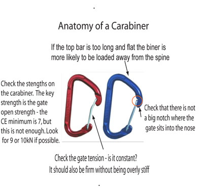

There is misconception that wire gates are stronger than solid gates. but in general this is not true. The only exception is in the minor axis test where the extra malleability of the steel wire gate can allow higher readings to be obtained. However this is the least important of the tests and minor axis loading should be virtually eliminated in well designed snapgates – the gate/nose interface is far more important and a far greater source of breakages.
The gate/nose interface – where the gate meets the body is the downfall of many wire gates because the design has been taken straight from its solid gate antecedents. This often means that there is a massive notch where the wire gate sits that is perfect for hanging up on wire/tapes/ropes and loading the biner away from the spine. This is made even worse if the carabiner has a long fat top bar a weak gate open strength and a weak spring. Simple stuff, but there are a lots of poorly designed biners out there - the current Clog wire gates are a good example of how not to build a carabiner.

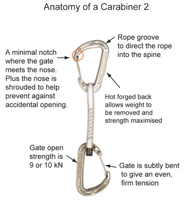

Choosing snap gate carabiners – key things to look for:
- A good gate open strength – 9kn or 10kN. 7 kN is just not enough – there is no margin for error in manufacturing tolerances and it is quite possible to generate 7kN in a fall especially when using a static belay device (GriGri) or a thick, old rope.
- A well designed body that drives the rope into the spine i.e., no flat long top bars.
- A minimal notch where the gate meets the nose of the carabiner to minimise the chance of items hanging up on the notch and so loading the biner away from the spine.
- Check the spring tension – it should be firm and constant without being stiff.
Choosing snap gate carabiners – nice finishing touches:
- A shrouded nose – helps stop the gate opening accidentally
- Anodising – help stop the biners seizing up
- Separate colours for either ends of the quickdraw on wire gate draws. One end of a draw should always be used for clipping gear and one end for clipping the rope – this is because the gear end often becomes marked and notched where bolts or hard materials dig into it under load. These nicks and marks can pull threads on ropes, slings and harnesses. Solid gate draws have a straight gate biner for the gear and a bent gate for the rope – no chance of mixing them up; however wire gate draws can easily be used the wrong way around unless the carabiners on the different ends are identifiably different
- Rope groove – helps keep the rope close to the spine.
